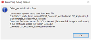

SDS200i debugger won't connect on CCS 12.1.0.00007.
Below is the result of debugger verification.
Can you confirm what the problem is?

We are not using EVB.
A sample has been produced using the AM2634.

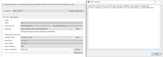

To further troubleshoot, I deleted the debug configuration and recreated it, and the following error occurred.

Understood, in that case can you please change the debugger to XDS110 debug probe in the CCS and give it a try please?
Hi, G Kowshik
I'm using the sds200i debugger.
However, this issue is resolved by running fsclean after exiting CCS.
