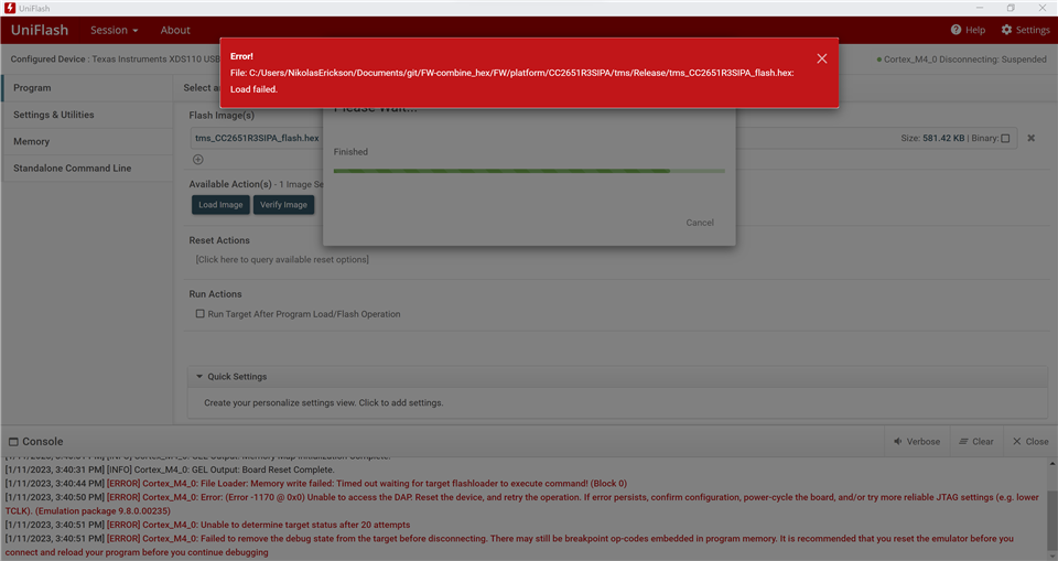

I am working with a CC2651R3SIPA and getting a "Load Failed" error when trying to flash the device with a combined .hex file.
The .hex file is a bootloader .hex concatenated with an application .hex (bootloader followed by application).
Here is the verbose from the error attempt:

[1/11/2023, 3:42:25 PM] [INFO] Cortex_M4_0: Writing Flash @ Address 0x00057fa8 of Length 0x00000094
[1/11/2023, 3:42:25 PM] [INFO] Cortex_M4_0: Chunk 1: addr=0x00057FA8, length=148, crc=0x6D673AD3 (using block 0)
[1/11/2023, 3:42:25 PM] [ERROR] Cortex_M4_0: Error: (Error -1170 @ 0x0) Unable to access the DAP. Reset the device, and retry the operation. If error persists, confirm configuration, power-cycle the board, and/or try more reliable JTAG settings (e.g. lower TCLK). (Emulation package 9.8.0.00235)

[1/11/2023, 3:42:28 PM] [ERROR] Cortex_M4_0: Unable to determine target status after 20 attempts
[1/11/2023, 3:42:28 PM] [ERROR] Cortex_M4_0: Failed to remove the debug state from the target before disconnecting. There may still be breakpoint op-codes embedded in program memory. It is recommended that you reset the emulator before you connect and reload your program before you continue debugging
[1/11/2023, 3:42:28 PM] [ERROR] Cortex_M4_0: File Loader: Memory write failed: Could not read 0x20000B4C: target is not connected
I am selecting CC2651R3 as the device and XDS110 USB Debug Probe as the connection.
Could someone provide some assistance for how to flash this chip with a combined bootloader and application .hex file?
Thank you,
Nik
  • Hello Nik,
    "Writing Flash @ Address 0x00057fa8 of Length 0x00000094" has an end address of 0x5803C which is outside the acceptable flash range of the device (max 0x58000).  It is likely that both hex images contain CCFG settings whereas only one should be present.  If you are using OAD projects then you should be attempting to combine the bootloader .hex with the application *_oad.bin using SRecord as instructed in the Combined Production Image section of the BLE Enhanced OAD Advanced SimpleLink Academy Lab.
