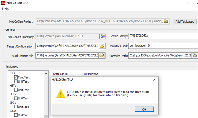

We are using the SAFETI-HALCOGEN-CSP to to run unit tests using TAU but the test sequence terminates abnormally when it tries to connect to the target.
We are using:
  • Hercules TMS570LC43x Development Kit
  • SAFETI-HALCOGEN-CSP 04.07.01
  • TAU 01.00.00
  • LDRAUnit-Ti-Qual 9.4.3
  • OS Windows 10
The output from TAU appears to be OK as follows :
Test Sequence : \Test\GIO\UnitTest
Generating MakeFile...Passed...
Generating TCF File...Passed...
Validating and building the test sequence...
Build Successful...
Executing testcases...
Test execution Completed...
However, at the point that it should execute the test cases, when the command window should appear and it should connect to the target and load & run the software, what it actually does is close the command window almost instantly and then completes execution, without actually running the test cases.
The CompileLog.txt file in the Debug directory does not contain any errors.
The Log.txt file in the UnitTest directory does not contain any errors.
We have tried running TAU on two different Windows 10 PCs and we get the same behaviour on both.
So it appears that something goes wrong when the TAU tries to connect to the target.
Do you have any idea what might be going wrong?
