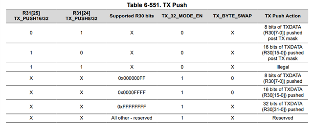

we would like to know 32 bit TX push operations from the below table 6-551 describes the supported configurations.

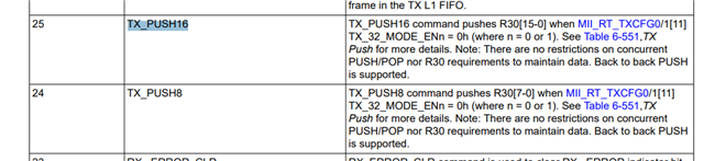

We only find the PRU R31 Command Interface (Write Mode) have TX_PUSH16 and TX_PUSH8, not have TX_PUSH32.
From table 6-551 describes, if we want to use TX_PUSH32 operations cmd, so we should set the TX_32_MODE_EN as 1, and using what the instructions for 32-bit transmit?
Or how to achieve 32-bit transmit operation? If the PRU R31 not support 32-bit transmit, we do not find any Notes./attention in the TRM. Thanks for your help and clarify.
  • Hello Shaoxing,
    You are able to enable 32-bit data push mode with TX_MASK disabled. In this mode, the internal PRU R30 byte write strobes are used and no the R31 CMD TX_PUSH. Additionally, any update to R30 will trigger a TX PUSH. 32-bit data mode can be enabled by setting MII_RT_TXCFG<n>[11] (TX_32_MODE_EN) to 1h. For more information on the TX control for MII, refer to the MII_RT_TXCFG0 Register.
