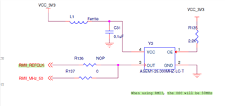

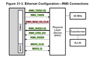

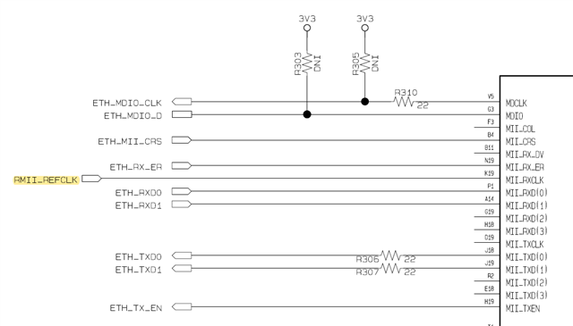

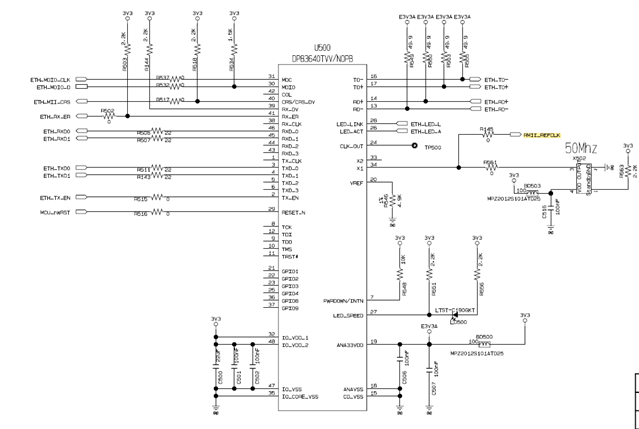

We have RM46_HDK_SCHEMATICS_REVE schematic in your reference design.
We want to config with mii interface between rm46l852 and DP83640 in your reference shematic.
what needs to change for mii in your schematic?
