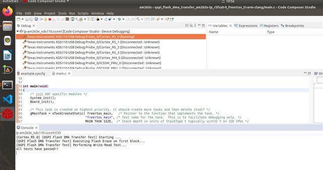

    2. Modify syscfg manually according to SFDP.  We changed
    a. MFGID from 0x01 t0 0xC2
    b. QE type from type 1 to type 2 according to mx25l12833f datasheet.
    c. Keep original "flashDeviceBusyTimeout" "flashPageProgTimeout" values.  The modified syscfg can be reference as.
    https://e2e.ti.com/cfs-file/__key/communityserver-discussions-components-files/908/3583.example.syscfg
    3. Use new syscfg with qspi_flash_dma_transfer demo project, we can pass 32K bytes read/write test.
    4. Base on this result, we use modified syscfg to rebuild sbl_uart_uniflash , sbl_qspi and sbl_null.
    5. Use new sbl_uart_uniflash to program sbl_null. We can boot from mx25l12833f successfully.
