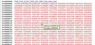

currently we are facing some issues in our bootloader which is based on the SBL OSPI bootloader. Sometimes the we get an assert here:
Which should be the following assert in ospi_dma_udma.c:
In what cases can this assert be thrown?
Since this is randomly appening on bootups what can we do against it?
Just repowering the board helps. I made a temporary fix where the asserts triggers a (software-)restart which is also fixing this issue. But we would still like to fix the issue at the root.
BR Fabian

  • Hi Aakash,
    thanks for the hint. I will check this again.
    Is this assert thrown because of some specific failure or is it a general assert with many root causes?
    Fabian
  • Hi Aakash,
    maybe you can verify the values we use, so we are sure they are set correctly.
    We are using these flashes:
    1. IS24WX256 https://www.issi.com/WW/pdf/25LX-WX256-128.pdf
    2. GD25LX256E https://www.gigadevice.com/datasheet/gd25lx256e/
    3. MX25UM25645G www.macronix.com/.../MX25UM25645G, 1.8V, 256Mb, v1.1.pdf
    I will attach you our configs for those flashes.
    Can you please help us out here and verify that we are using the correct values for the configs? SPI is configured to 166Mhz.
    Thanks!
    Fabian

  • Hi ,
    It seems like you are using a very old version of MCU_PLUS_SDK. Do you intend to migrate to 08.05 release of SDK. The SDK has updated methodology which will help you configure the flash driver better.
    Here is the link for the same - https://software-dl.ti.com/mcu-plus-sdk/esd/AM243X/08_05_00_24/exports/docs/api_guide_am243x/CUSTOM_FLASH_SUPPORT_GUIDE.html
    If you can send the *.json files generated for all the flashes that would help us debug even faster.
    Aakash
  • Hi Aakash,
    yes we are on a older version of the SDK.
    For background:
    We need to configure the flash at runtime since we do not know which of the three are placed during production.
    Therefore we read via Single SPI the Device ID and configure the flash driver accordingly. For this we had to do some changes to the SDK. Therefore a upgrade is not that easy.
    BR Fabian

    Also some screenshots of how the read out memory looks after the call of OSPI_phyReadAttackVector at 0x60000000 via memory browser:
    old driver:
    new driver:
    it seems only some values match and then somehow all memory after that has the same value. Maybe that helps to identify the problem better.
