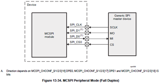

2-SPI
  • what are SPI_D0 and SPI_D1? How we could map them into MISO and MOSI?
3-LIN

    2) SPI
    2a) These details and much more information can be found in the Peripherals - General Connectivity Peripherals - MCSPI chapter of the TRM. (AM263x Technical Reference Manual)
