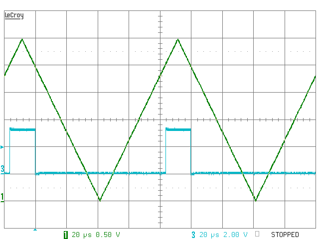

As an additional information I was able to configure the comparator for a low going output if the input value being digitized is bigger than 3072 with respect to the 12Bit input range from 0..4095. What I would need is an additional level saying it shall go low as well if the digitized value is below a certain level, say less than 1024 for example. This is shown in the scope-shot below. How can I accomplish this?
Channel 1 Yellow Function generator input
Channel 4 green DAC output
Channel 2 Magenta ADC tick pulse 2 MHz
Channel 3 Blue Comparator output but only for values bigger than ...
If for example I use the demo-project from TI "cmpss_asynchronous_trip_am263x-cc_r5fss0-0_nortos_ti-arm-clang" I can configure the high comparator to create a pulse whenever the input signal is higher than the configured value. In the example shown below the DAC value for the high comparator is 3072. We assume an input signal that is using the full scale range from 0..4095. The scope-shot shown below demonstrate it works.
Green is the analog input signal ~0..3Vpkpk.Blue is the comparator output CMPSSA0 on pin R3 whenever the input is higher than the configuration done in the syscfg-tool being 3072. For me it looks like it works. Now adding some more configuration for the comparator submodule CMPSSA0 I do configure the so called lower comparator for a treshhold value of 1024 and invert its output in order to get an additional high going pulse (Blue trace) whenever the input signal (Green) is below this lower value (1024). However nothing alike happens ... ?

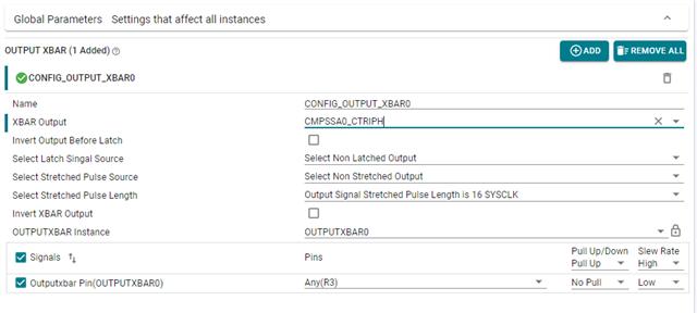

Within the output xbar section of the sysfg-tool I add the output of the lower comparator. Running with the addition of the lower comparator and the output XBAR oring function nothing changes. I do get the very same scope-shot as shown above. It looks like the lower comparator has no effect. I may have made a wrong configuration I don't know. The demo program with the modifiction I made is attached.

    In my understanding for a "window a-like function", the only thing I would need is to configure the two treshhold levels while inverting one of the comparator output and oring the two comparators 'H' and 'L' in order to get this function. Addidionally I use the output of the binary filters in order to smoothen the transistions. That's what I did set. However nothing happens. For me it looks like the comparator 'L' is not reacting at all ...

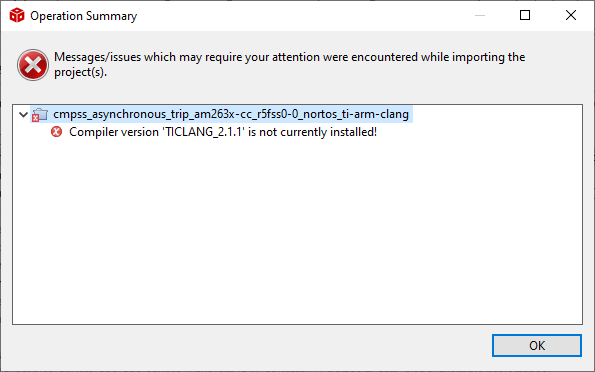

  • Hi Sri Vidya,
    thank you for the upated. I did download and install the referenced SDK and the ref. SysCfg-Tool. After trying to re-import the very same example project from the SDK's example section I do get the following error info. This is after a reboot of my machine after the installation of the two packages was done.
    I do use TI-CCS version Version: 11.2.0.00007
    The compiler installed is the version TI C Lang V1.3.1.LTS
    Do I need to upgrade the TI-CCS IDE as well ?
    br
    Markus
    Finally I was able to get the windowing function using the comparator submodule within the AM2634. Thank you for your help. I did the following to achieve it:
    - Upgrade to the TI C Lang compiler V2.1.2
    - Upgrade the SDK to the version 08.05.00.24
    - Upgrade the SysCfg Tool to the version 1.14.0.2667
    I still use the eclipse based TI-CCS version 11.2.0.00007. Therefore I assume that this is okay.
    You may need to update the preference section within TI-CCS to make th new installations visible to the system. And you may need to update the properties section of the CCS project you are working on to the new available products like compiler, syscfg and the SDK.
    The window-comparator output (Blue trace) goes high whenever the input signal on the ADC0_AIN0 pin (Green) is above or below the treshhold set in the syscfg tool of the sample application based on "cmpss_asynchronous_trip_am263x-cc_r5fss0-0_nortos_ti-arm-clang" from the SDK example section. The two comparator outputs needs to be 'ored' in the GPIO Output Crossbar section as well. The lowever comparator is inverted.
