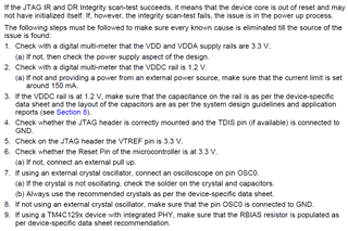

            I checked 1 through 7 listed in your Application Report SPMA075, page 27.
            https://www.ti.com/lit/pdf/spma075
            1 through 6 were fine. 3.3V and 1.2V were there. 16MHz crystal on my PCB was not oscillating.

    I would suggest testing the microcontroller pins to see if there is any evidence of a possible short then. If the unlock process is succeeding but the MCU can't be programmed, I would expect some sort of damage has occurred whether it was ESD or an overvoltage/current. The unlock process results in Flash being completely cleared and registers being reset so nothing should prevent JTAG access at that point.
    You may also want to see if the device is sinking more current on a failed board versus a functional board.
