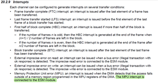

During the implementation of the DMA9A Diagnostic mentioned in the Safety Manual, we noticed that ESM 1.2 does not get set on the forced memory access violation of the dma.
However the REG0FT bit gets set (we are testing region0).
Based on this, the test seems to work as intended, but signalling the error to esm seems to be disabled.
But we noticed that ESM 1.2 Error is set, when INT0ENA is set. As far as we understand, this bit enables all interrupts of the dma module region 0.
(Q1) Is the signalling of the ESM error dependend on the enable state of all dma-interrupts?
(Q2) If this is the case, how can we enable ESM error signalling without using the dma Interrupts FTC, LFS, HBC, and BTC ?

  • Hi Max,
    Not on all the DMA interrupts, the ESM 1.2 error will be dependent on the state of the MPU related interrupts only.
    This is not the case, there is not relation between ESM1.2 and FTC, LFS, HBC and BTC interrupts.
    It will just depends on MPU region wise interrupts like INT0ENA, INT1ENA, INT2ENA and INT3ENA.
    refer 20.3.1.64 DMA Memory Protection Control Register 1 for more details.
