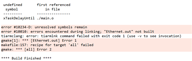

I'm getting an error while trying to compile the code when using  vTaskDelayUntil function
This is the error:
This is the simple code that produces an error:

vTaskDelayUntil(&xLastWakeTime, xFrequency);

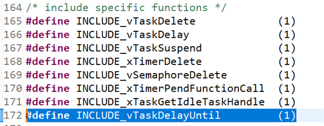

I tried to edit FreeRTOSConfig.h file by adding line 172 but the error persists:
Can I simply edit FreeRTOSConfig.h file if I want to change the behavior and functionality of Freertos?
