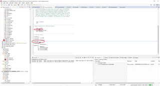

My project is running using FreeRTOS which is generated from HalCoGen on Hercules Development Kit. Multiple tasks are running in the design. One of the tasks is to read and write from the Flash using TI FEE functions.

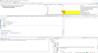

I am facing an issue when I try to use TI FEE functions from the FreeRTOS task. The task hangs in TI_Fee_Init() forever. The TI FEE functions are working fine when running outside the tasks.
My issue is similar to the following post.
https://e2e.ti.com/support/microcontrollers/arm-based-microcontrollers-group/arm-based-microcontrollers/f/arm-based-microcontrollers-forum/632209/rtos-tms570ls1224-call-fee-functions-from-freertos-tasks-hangs
All the links and files mentioned in the post are inaccessible. Can anyone please send me the correct links and files?

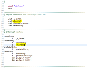

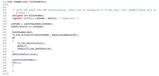

Also, based on that post, I should switch from user mode to supervisory mode to execute the TI FEE functions. Can anyone please help me understand how to switch the processor to supervisory mode?
