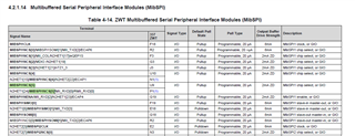

I'm starting out with a TMS570LC4357 design and will be using many SPI interfaces and devices that I can't daisy chain, hence I will require separate chip selects to each device.
I just want to get something 100% clear in my mind upfront before progressing regarding the multiplexed pins.
For example Pin R2 - MIBSPI1NCS[0]/MIBSPI1SOMI[1]/MII_TXD[2]/ECAP6
Can you confirm that if I am using MIBSPI1 as a 2 bit interface i.e. MIBSPI1SOMI[1:0], that I will only be able to utilise the MIBSPI1NCS[4:1] pins?
i.e. MIBSPI1NCS[0] is inaccessible as it is now configured for use in the 2 bit data transfer.
Likewise if I utilise the all the N2HET1's pins (F3, G3 & J3) then I can only use the MIBSPI1NCS[4] output us a chip select.
So looking through the various mux'd pins it looks like using a selection of peripherals may mean that other peripherals, or parts of their functionality, will not available to me.  Which is when the real development fun starts :)
If I am correct in all the above, is there a tool maybe in Excel that will show me what is available if certain pins are allocated?  I am guessing HALCoGen may do this, but I've not delved into this yet as I'm looking from a hardware allocation side of things.
John
  • Hi John,
    Yes, agreed that you can't use MIBSPI1NCS[0] if you used MIBSPI1 in 2-bit interface mode. But here we have MIBSPI1NCS[5] also
    So, you can use MIBSPI1NCS[5:1] pins.
    In this case you can use MIBSPI1NCS[4] and  MIBSPI1NCS[5].
