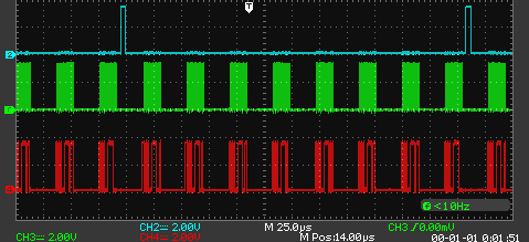

  • I use example ssi_master_slave_xfer. I try 10 times to get the same sequence, but each time I get a new array of 8 elements...

    SSI2 Received: '1'
    '43250' '43251' '43252' '43253' '43254' '43255' '43256' '43249'
    Master-Slave Transfer Complete.
    SSI2 Received: '2'
    '43253' '43254' '43255' '43256' '43249' '43250' '43251' '43252'
    SSI2 Received: '3'
    '43249' '43250' '43251' '43252' '43253' '43254' '43255' '43256'
    SSI2 Received: '4'
    '43252' '43253' '43254' '43255' '43256' '43249' '43250' '43251'
    SSI2 Received: '5'
    '43256' '43249' '43250' '43251' '43252' '43253' '43254' '43255'
    SSI2 Received: '6'
    SSI2 Received: '7'
    '43255' '43256' '43249' '43250' '43251' '43252' '43253' '43254'
    SSI2 Received: '8'
    '43251' '43252' '43253' '43254' '43255' '43256' '43249' '43250'
    SSI2 Received: '9'
    '43254' '43255' '43256' '43249' '43250' '43251' '43252' '43253'
    Array from master: '43249' '43250' '43251' '43252' '43253' '43254' '43255' '43256'
    Waveform:
      I think after the below line you need to reset the g_breceiveFlag to 0 again.
            while (g_breceiveFlag == 0);
            g_breceiveFlag = 0; // Add this line
