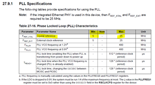

Hi Hiroyuki-san,
There is an on-chip PLL on TM4C129 MCU. The PLL can multiply the input reference clock to produce a final system clock up to 120Mhz. The user can configure the system clock per your application requirements. The input reference clock for the PLL is limited between 5 to 25Mhz. Please see below from the datasheet.
Since you are interested in the USB operation, there is this note in the datasheet for USB concerning the clock. If you are running the device system clock at 120Mhz then you will be ok.
Note: When the USB module is in operation, MOSC must be the clock source, either with or
without using the PLL, and the system clock must be at least 30 MHz.

You don't need a 30Mhz crystal. What I was showing was the system clock must be higher than 30Mhz, not the crystal. The system clock is generated by the internal PLL taking MOSC (between 5 to 25Mhz) as an input.

I don't see a problem using 16Mhz MOSC.
So you're saying there's no problem even if you're not using the recommended oscillator for testing that's listed in the datasheet?
In the datasheet, it lists part numbers of crystals that have been simulated and confirmed to operate within the specifications shown for Main Oscillator Input Characteristics. Other crystals that have nearly identical crystal parameters can be expected to work as well.
