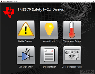

Hello everyone! I need some help with both sensor on the board.
Is there anything examples of these sensors?
I'll like to read and write the information sensor throgh SCISend in the CCS.
Thanks a lot !

Hi Federico,

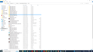

I will suggest you download "Hercules Safety MCU Demos" from below path.
HERCULES_SAFETY_MCU_DEMOS Code example or demo | TI.com
After downloading and install you can see demo projects for different Hercules MCU devices
In this you can open the project called "TMS570LS3x_target_sources"
..\Hercules Safety MCU Demos\4.0.0\TMS570LS2x_target_sources
This is an integrated demo of below projects.
If you are using TI specific HDK board then you can use this demo directly and there is a software app as shown in above pic and there you can see the data in GUI as well.
Thanks & Regards,
