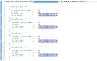

Hello good morning.,
Iam working an application, so I need to store some values in the EEPROM memory locations of TMS570LS3137 i.e., Bank-7(64KB), Iam configuring the 4 physical sectors into 2 virtual sectors.,In configuration of virtual sector size, Iam unable to get want is meant by Fapi_FlashSectorType is it decides the size of the virtual sector? if it is how? and one more question
In tms570ls3137 we have 31 physical sectors for the total flash memory,but in the types.h Fapi_FlashSectorType are 64 ? why?
I need to use this feature(access eeprom) in top of my application,Is I need to call an interrupt for every write and read cycle?
iam new to the devolpment application.,
please give me some answers regarding above questions.,
thanks in advance.,
    Fapi_FlashSectorType won't decides the virtual sector size, it is a enum type structure and which will give a value to the each physical sector of EEPROM.
    Example:
    Fapi_FlashSector0 with value 0, Fapi_FlashSector1 with value 1 and Fapi_FlashSector2 with value 2 etc...
     Actually, the actual virtual sector size would be decided by the Start Sector and End Sector values we are giving in the Fee_VirtualSectorConfiguration.
    For example, the above configuration indicates that virtual sector-1 will be start at physical sector-0 of Bank-7 and end at physical sector-0  of Bank-7 so that means one physical sector-0 of Bank-7 is used for virtual sector-1.
    Similarly virtual sector-2 will be start at physical sector-1 of Bank-7 and end at physical sector-1 of Bank-7 so that means one physical sector-1 of Bank-7 is used for virtual sector-2. and same thing applicable for other virtual sectors.
    These configurations can be easily change from HALCoGen
    Note: Fapi_FlashSectorType doesn't implies any size, the physical sector sizes are already fixed and given in TRM, so when we mention start and end sectors in above configurations then that many physical sectors will get assigned to the corresponding virtual sector.

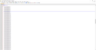

    This is because the F021 Flash API is common for all the hercules devices
    So, the configurations are given for maximum possibility. If you verify the max sectors possible in hercules devices would be 64 so the Fapi_FlashSectorType is given for 64, end of the day this is just enum type which implies numbers to the sectors, so there won't be any issue.
