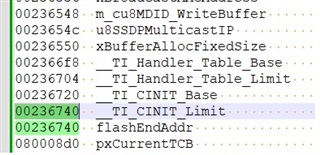

The Problem
Once we program the device, we look at the .map file and find the __TI_CINIT_Limit address
And then we find the FLASH in the RM57L843 is 0xFFFFFFFF at that location.
This means that C Init system will run on until 0xFFFFFFFF, which takes quite some time.

Any suggestions as to why the last word address is 0xFFFFFFFF?

  • Hi Stomp,
    The __TI_cinit_table starts at 0x236720, and ends at 0x236740, and the table size is 0x20
  • Hi QJ,
    Turns out it was not the "__TI_CINIT_Limit" as defined by the linker, but the way the CINIT table was being generated.
    Here is my output:
    LINKER GENERATED COPY TABLES
    __TI_cinit_table @ 00006d48 records: 4, size/record: 8, table size: 32
    	.data: load addr=00006ce0, load size=0000003f bytes, run addr=080703d0, run size=00000168 bytes, compression=lzss
    	.kernelBSS: load addr=00006d2c, load size=00000009 bytes, run addr=08003000, run size=00000140 bytes, compression=lzss
    	.bss: load addr=00006d38, load size=00000008 bytes, run addr=08003800, run size=0006cbce bytes, compression=zero_init
    	.os_swi: load addr=00006d40, load size=00000008 bytes, run addr=00000020, run size=00000004 bytes, compression=zero_init
    You can see that .os_swi actually has a run addx which is inside FLASH memory, this caused the data abort that I through was caused by exceeding the CINIT table limit.
