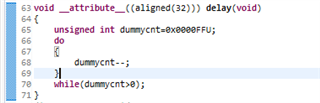

Hi Mathieu,
Yeah CODE_ALIGN didn't work for me as well.
You can try aligned attribute, i tested it worked for me.
Here is an example to align to 32byte
In above example it aligns start address of delay function to 32byte multiples.
Thanks & regards,
Jagadish.

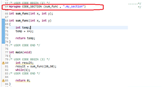

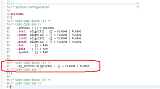

Hi Mathieu,
We can do using linker script.
Do the following steps:
1. Create one "my_section" in linker script with required alignment.
2. Now use CODE_SECTION pragma to allocate required function to the "my_section".
Please refer attached example if necessary.
Function_align_compiler_20_2_1_LTS.zip
Thanks & regards,
Jagadish.
