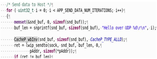

I am working on AM2432 with SDK mcu_plus_sdk_am243x_08_05_00_24 on a custom board
I am trying to fix a problem with a simple TFTP server.
The issue arises from UDP traffic, when the server receives a request on UDP port 69 and it replies to client port from a UDP port different than 69.
The ACK message should include only 4 bytes with ACK opcode and block number 0 but the server will deliver a reply with UDP header correct and with UDP payload only zeros.
I have tested that the pointer to a static buffer passed to lwip_sendto is properly filled.
Digging into the LwIP code I have seen that a pbuf is allocated for my 4 bytes and then another pbuf is allocated and concatenated to add UDP header.
Apparently it seams that DMA is transferring just the pbuf with UDP header, discarding the concatenated pbuf ( I suppose ... ).
