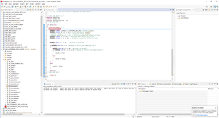

  • Hi Andrew,
    I created an example and tested at my end it is working fine.
    Actually, after i studied i understood, by default HET[n+1] will act as output and HET[n] will act as input, so if i am not wrong may be you tried to write to the HET[n] which is input by default.
    HET_LOOPBACK_TEST_LC4357.zip
    /* USER CODE BEGIN (2) */
    #define ENANLE 0xA
    #define DISABLE 0x5
    #define LBPTSTENA_BIT_POS   16
    /* USER CODE END */
    int main(void)
    /* USER CODE BEGIN (3) */
        hetInit();
        hetREG1->LBPDIR = ENANLE << LBPTSTENA_BIT_POS; //Enable Loopback
        hetREG1->LBPDIR &= ~(1 << 0); // HET1[1] as output and HET1[0] as input
        hetREG1->LBPSEL |= 1 << 0;  // Selecting Pair HET1[0] and HET1[1]
        hetREG1->LBPSEL &= ~(1 << 16); //Selecting Digital loopback
        hetREG1->DOUT |= 1 << 1;    //Writing 1 to HET1[1]
        if(hetREG1->DIN & 1 << 0) //Reading to HET1[0] and comparing with 1
            hetREG1->DOUT &= ~(1 << 1); //Writing 0 to HET1[1]
            if((hetREG1->DIN & 1 << 0) == 0) //Reading to HET1[0] and comparing with 0
                result = true;
            else
                result = false;
        else
            result = false;
        while(1);
    /* USER CODE END */
        return 0;

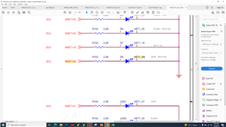

    However, what I have observed is that this example causes the LEDs on the board to turn on.
    I am running this example on the TMDX570LC43HDK Hercules TMS570LC43x Development Kit.
    For instance if I change your example code so that HET1[29] is output and HET1[28] is input.
    Then write 0 to HET1[29] first followed by writing 1 to HET1[29].
    Then when while(true) is reached LED D8, Left bottom, is on.
    I was not expecting this behaviour because I thought that the loopback values would not be seen on the pins in Digital Loopback Mode.
    Do you see the same behaviour?
    Thank you.
    Andrew
  • Hi Andrew,
    I don't see this behavior at my end because i tested this on Launchpad and not in HDK board
    Just now i verified the schematic of HDK board
    As you can see here HET1{29} connected to a LED on the HDK board, due to this LED is toggling whenever you are trying to write data on HET1[29].
    Thanks & regards,
    Jagadish.

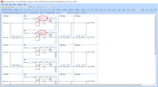

  • Hi Andrew,
    I checked it now and i could see the issue you mentioned at my end as well. But i could resolve the issue by commenting out the "hetInit" function.
    After commenting this function i could see proper operation for digital and analog loopbacks.
    In digital loopback i didn't see any values on the GIO pins(i.e. output buffers got disabled) but loopback worked as expected i.e. values written on HET1[0] got loopback to the HET1[1].
    In analog loopback i can see values on GIO pins (i.e. output buffers not disabled) and loopback also worked as expected i.e. values written on HET1[0] got loopback to the HET1[1].
    Can you please test the same and confirm from your end?
    Thanks & regards,
    Jagadish.

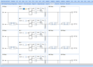

  • Hi Jagadish,
    Thank you for your reply.
    I can confirm that if I comment-out the hetInit() function then I observe the same behaviour as you.
    i.e. In digital loopback the LEDs are not turned on.
    And in analog loopback the LEDs are turned on.
    In my case this is because I use hetInit() to configure the HET pins as GIO output.
    If hetInit() is not called then the default GIO direction is input.
    It appears to me that the configuration of the GIO direction overrides the analog/digital loopback configuration.
    I also use hetInit() to configure the module pull-ups/pull downs.
    So, not calling hetInit() is not really a satisfactory approach for me.
    I think that the problem is that the loopback behaviour for the HET module is not as described in the TRM. Do you agree?
    Thank you,
    Andrew
  • HI Andrew,
    You are right, if we configure pin direction as output then the output buffers not getting disabled even after we are configuring to digital loopback.
    Actually, no need to stop calling "hetInit" function you can call this function but just don't configure pin direction to output for the pins which we are using for loopback
    If you do that then you can call "hetInit" function and there won't be any problem. Once loopback testing completed, you can disable loopback and can configure required pin direction in the code itself.
    Thanks & regards,
    Jagadish.
