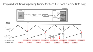

  2. Set up a local timer interrupt, how can the interrupt be synchronized with the ethercat bus SYNC? Can an IO input port latch the timer count value? If so, which peripherals should be used to implement it?
  3. The bus SYNC signal can be synchronized with PWM, SINC and encoder, so can PWM, SINC and encoder be synchronized with the input of a certain IO port? If so, which peripherals should be used to implement it?
      [MW] It can be done via the PRU-ICSSG IEP
      [MW] See above answer.
