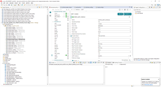

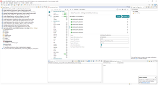

  • Hi Hong,
    1) the cache is enabled in SysCfg MPU ARMv7:
    2) For interrupt, there two ways to enable interrupt: a) using the SysCfg Peripheral configure (UART, Interrupt Mode for Transfer Mode)
    b) Explicitly use  HwiP_construct();
    Ming
