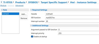

So, using the XGCONF window, I was able to create a hwi, setting the interrupt number = 30 (as from the table in the datasheet), and associating the corresponding hwiFxn that I have written in the empty.c. file.
The function in the empty.c is the following:
int32_t read;
uint32_t Value;
Void myADCFnx(UArg arg){
ADCIntClear(ADC0_BASE, 0);
read=ADCSequenceDataGet(ADC0_BASE, 0, &Value);
Now, after fix some problems, I finally was able to build the project without errors or warnings.
BUT, I am not able to "generate" the interrupt. This is probably the main goal that I wanna reach.
Once the interrupt was correctly generate/recognized "It's all downhill from here"!!!
Setting a breakpoint on the above function, in debug mode, I'm sure that the function was never called.
Probably I miss something or I am setting something wrong.
Can you help me? xD
