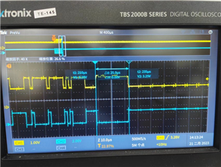

AM2434: the end of CAN frame level width error
Part Number: AM2434
Hi team,
This figure shows the end of CAN signal. The yellow is CANH, the blue is chip tx pin, and the last level is more than 24us. The bus is 500K. This level width obviously does not meet the 11898 standard, which will cause other ECUs detect errors.
