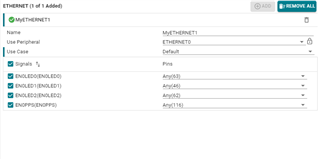

When selecting Ethernet within Sysconfig (online tool) the fixed functions pins of the Ethernet are not listed (pins 53, 54, 56, and 57). Can you please let me know if I'm missing something?

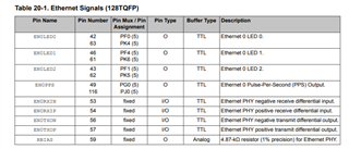

Hello Lenio,
Those are the only I/O that would be configured from a SysConfig standpoint. The remaining Ethernet pins are fixed function:
