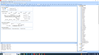

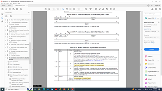

I have managed the setup the CAN1 peripheral in the TMS570LS31HDK. I have managed to both transmit and receive can messages. However, all of the transmit messages are of the Extended format. Also it received only Extended frame CAN messages. How can I change the CAN ID format to standard ?
Nisal
