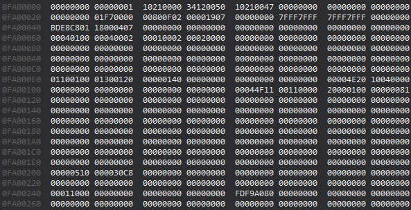

    Thanks for sharing MMCSD1_NORMAL_INTR_SIG_ENA / MMCSD1_NORMAL_INTR_STS_ENA outside the PRU ISR. From your snapshot, I understand:
    • MMCSD1_NORMAL_INTR_SIG_ENA = 0x7FFF
    • MMCSD1_NORMAL_INTR_STS_ENA = 0x7FFF
    What are the values of these registers inside the PRU ISR?

    From your snapshot, I understand MMCSD1_NORMAL_INTR_SIG_ENA/MMCSD1_NORMAL_INTR_STS_ENA have these settings inside the PRU ISR:
    These look normal.
