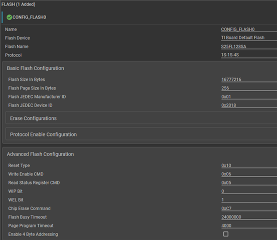

I am working with the AM2634 Control Card with SDK 8.05. The QSPI flash driver (S25FL128SA) has been configured using sysconfig and is working as expected when accessing data in the first half of the address space (<0x800000).
The below image shows the sysconfig FLASH configuration:
When attempting to write/erase data at addresses >0x800000 the data appears to be unchanged, but no errors are returned from the flash driver API calls.
Has flash write/erase behavior been tested at sectors with addresses in the upper half of the memory map? I'm suspicious that the block protection is enabled for the upper half of the memory map; is there an API to read the status register of the part?

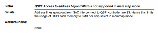

  • Hi ,
    There is a HW errata identified (i2364). Please find the details in the document linked - https://www.ti.com/lit/pdf/sprz488
    In memory map mode, the flash address limitation remains for 23 lines and hence the flash can only be accessed for 8MB only. Although, in config mode, the flash can be accessed for entire 4GB.
    Aakash
