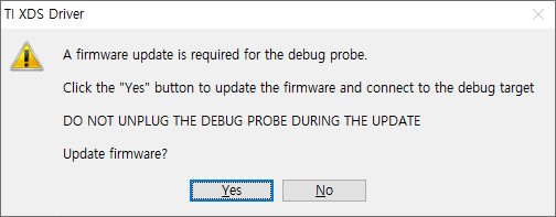

I'm currently using EWARM to build and download program to RM48L952 device. When I select debug and download a window shows that XDS110 requires firmware update.
It won't allow me to download without firmware update. And if I choose yes then it tries and fails update.
After this, the debug probe is bricked and windows/xdsdfu can't recognize it. I have to open the case and flash the bootloader, then download the firmware.
How can I solve it?
