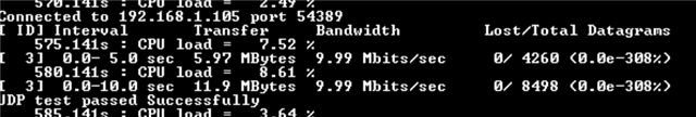

  • Hi Nilabh,
    1) The packet size is closer to MTU size, ~ 1460 bytes

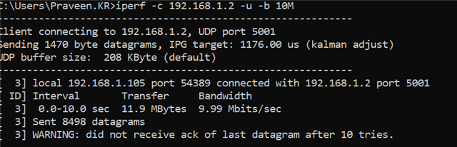

    2) Below are the results for UDP iperf test,
    The uart log from evm shows packet loss of 28% for 50 Mbits/sec throughput.
    To achieve 0 % packet loss i had to set iperf bandwith as 10 Mbits/Sec
    The use case is to demonstrate gigabit throughput capabilities to the client.

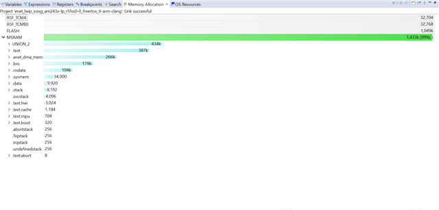

    We have observed a TCP throughput of ~125 Mbits/Sec which is a ~50% increase from previous test results.
    We also observe that the MSRAM utilization is around 99% with these settings. Please confirm that this is expected.
    As we are currently in the design phase, please clarify on the excepted RAM utilization for ICSSG application with the performance improvements you are planning.  Also, please clarify whether we will need an external RAM as we observe very high RAM utilization currently.
