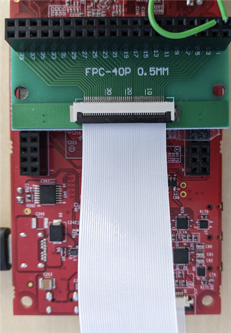

    I'd like to have some assistance with the test automation interface. Specifically, how to drive the IO expander. I don't seem to get any response from it. My actions:
    1. I have set all DIP switches that control boot mode, to "off":
    2. I wired an external micro to the test header, pins 37 (CLK) and 39 (SDA):
    3. I scanned the I2C bus, addresses from 0 to 120, and got no response.
    4. I verified other pins of the test automation header - e.g. 1,2,3,7 - and they are indeed 3v3 & GND, per spec.
    5. I connected to the BoosterPack headers and scan I2C0 pins, I get expected responses from addresses 80, 81, 96.
    What I am missing? How can I talk to the bootmode IO expander?
  • Hi Sergey Lyubka,
    Few quick checks,
    1. The external header(FPC breakout FPC-40P 0.5mm) pin numbers in the image you have above, shows that the pin numbers start from Bottom right(in the above image) with Pin 1, so the pins 37 and 39 should be on the bottom left of the black connector. I see two wires(these are the SDA SCL wires from your I2C controller?) connected to pins 2 and 4, so please cross-verify if those are correct.
    2. Also, you would have to connect the GND from your I2C Controller along with the SDA and SCL, please ensure this too.
    3. On the LP-AM243 board, the IO Expander gets power through "VCC3V3_TA" net, so please check once on TP49 to see if the LDO U41 which powers the IO Expander is powered On or not.
    Tejas Kulakarni

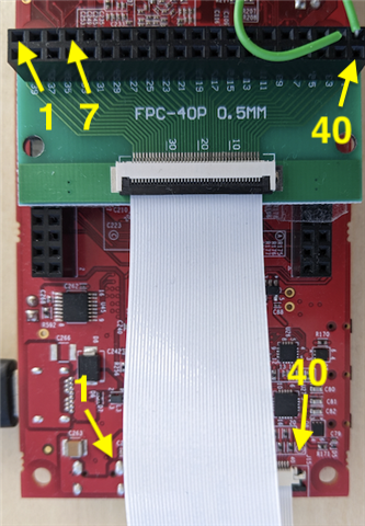

  • Tejas,
    Thank you for following up. I think my pinout was correct.
    I've marked the pins on my picture:
    1. I checked TP49 : it has 3v3 indeed.
    2. I checked pins 1,2,3 - they have 3v3.
    3. Pin 7 is 0 volt, and it is connected to the GND  (my tester beeps)
    4. Pin 40 also GND (beeps)
    5. Pins 37, 39 are 3v3 , which I think is correct, since SDA and SCL should be high when idle.
    My external MCU is wired to the 3v3 and GND of the booster pack. I believe GND is shared, because if I touch the GND on my external MCU and pin 40 on the test header, it beeps.
    I cannot talk to the expander. If I re-wire my MCU to use I2C0 on the booster pack, I can talk to the I2C devices indeed - address 80,81,96. I use 100kHz I2C frequency.
    Do you have any clue what I may have done wrong?
  • Hi Sergey Lyubka,
    Everything looks fine, not sure what we are missing.
    If you have access to an Oscilloscope, can you please probe once on the LP-AM243's J15 Test Automation header I2C pins(Pins 37 and 39), and check if you can see the I2C transactions when the I2C controller tries to communicate to the IO Expander(U26)? This is just to ensure we are indeed getting the I2C signals onto the IO Expander from the external I2C controller.
    Tejas Kulakarni
  • Tejas,
    Thank you for your support.
    It turned out, the problem was a loose FPC cable connection. When corrected, the expander indeed answers on address 32.
