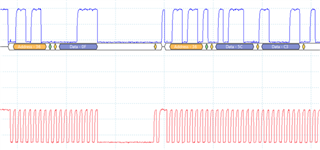

However, when I port this to my A3DPDemo_Src  project it does not work.  The stop condition is generated by the peripheral and kills the repeat start condition thus breaking the read function all together and causing the state machine on the KT Micro device to return incorrect data for the read.
This is a good read using the sample code I got from the link above.  You can see the stop condition happens and the read brings back a valid value.
And when adding the same code in my Project  you can see that the stop condition happens and read returns bad data:
Furthermore, the sequence never ends leaving the peripheral in an unknown state.
Since I noticed that the I2C peripheral is very timing dependent I would like to add that the sample code is running at 3MHz MCLK speed and baud rate of 100Kbps while my Project has a 24Mhz clock and 100Kbps baud rate.  I essentially tried to increase the delays in the code by 8X but that did not work.

  • The code that I am currently using is also DRM for the most part except for set up and the initial send ..   I can break down initial send portion to DRM level and see if  that helps and get back to you.
  • Hello Ozzy,
    I was able to get ahold of another engineer to review your situation with and a couple ideas that came from that review are:
    1. Since the example project is running at 3 MHz and that works, can you add clock configuration code to that example in order to get the MCLK running at 24 MHz? This would allow you to test the combination of the higher system clock plus 8x increase on delay in the working example code. If that works correctly then the issue would be more specific to your application but if the example code breaks at the higher clock rate than the root cause is that the workaround provided has a limit.
    2. If running at 24 MHz with the extended delay does not work, then a question that comes up is if the sequence of checking flags etc. is executing too rapidly. For example perhaps the initial delay is important, but if the code executes too quicky then the repeated start is coming out quicker than it would at 3 MHz and is being registered as a stop condition instead - part of that thought is due to how the waveform for the repeated start signal seems to be a narrower spike for your 24MHz code.
    If the issue is repeatable for a MSP432 LaunchPad at 24 MHz with the basic example code, then that would allow us to replicate the failure and look into the flags etc. as well.
    Ralph Jacobi
  • Ralph,
    I went back and made all of the code DRM and this didnt work.
    I then checked the MCLK speed of the sample project that works vs the MCLK of my application.  The sample project is running at 3Mhz while the A3DPDemoSource project is running at 24Mhz which is needed to handle the Bluetopia stack and the MIPS required to maintain BT working. I started to increase the sample project MCLK speed to see if it could handle the faster clock.  At 6 Mhz the Repeat Start condition works fine and at 12 Mhz as well after increase the delay that happens after the module is enabled.  However once I go to 24Mhz it breaks and I start to see the same results that I see in my project.
    Has anyone tested the I2C repeat start condition at 24Mhz MCLK?   Other functionality works but not the repeat start condition.
    Ozzy

  • Hello Ozzy,
    While testing the previously provided example, my colleague was able to re-create the code breaking at 24 MHz on a MSP432P4 LaunchPad talking another LaunchPad. Based on this an adjustment was made to add before checking for the flag which is followed by the stop bit. For their testing that resolved the issue.
    The code for that is as follows:
    /* --COPYRIGHT--,BSD
     * Copyright (c) 2017, Texas Instruments Incorporated

    The delay inserted is 250 cycles, and from the testing, 100 cycles was not sufficient, but 200 and above works fine. 250 was chosen to leave some buffer.
    Please see if that adjustment works for both your example project and your Bluetopia project. If it does not work with your example project, we'll need to get your example project posted to compare setup etc.
    Ralph Jacobi
  • Ralph,
    This did the trick.
