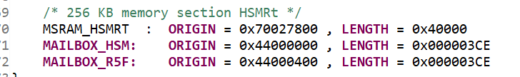

    All I changed was to change the start address of "MSRAM_HSMRT" to 0x70040000 as shown below.
    MSRAM_HSMRT: ORIGIN = 0x70040000 , LENGTH = 0x00040000

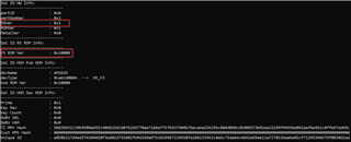

    Can you send me the snippet of passing scenario in your case ? It should be like this -
    The LoadHsmRtFw time should be approximately 6ms. Also can you send the snippet of the parsed UART Boot Log print ? Use the following FAQ for the same.

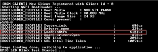

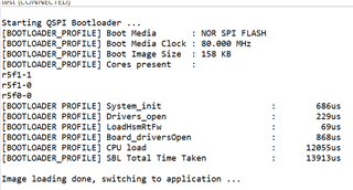

    First of all, if I use the SBL example without changing it, the log will be output as shown below. (but LoadHsmRtFw is 69us)
    And when I change the MSRAM_HSMRT area from 0x70027800 to 0x70040000, no log is output. (I haven't modified anything else in the example.)

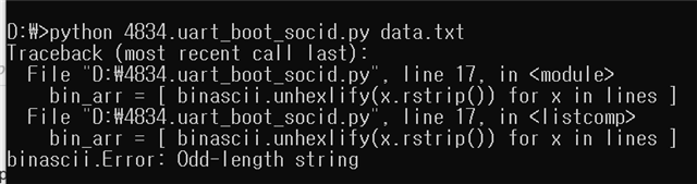

    And I tried the method in the link, but an error called odd-length occurs as shown below.

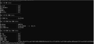

    And I got the data like below from UART BOOT and used it.
    000002020100000000000100414d323633580000000000000400cdab00000100010000000000000000000000000000000000000050d39632c39b4506e692c404625dcb0762b9770ae7166e7f1fb537404b7beceba254256c884d098cdb906573b92ee15169f9493be861bef6e4b1c8ffe67edb9c00000000000000000000000000000000000000000000000000000000000000000000000000000000000000000000000000000000000000000000000000000000a858b217d4ed374104020f3ed82d735602fb9d259a97b1826967219658fa186133542c8e6c75da6dc6642e69ae11a7278526aabe02cf712953b0379f0820d2aaC

  • Hi Jiung Choi,
    The HSM-Rt Firmware time for installation in your case is 6us. It seems like your firmware is not installed at all. This is because your device version is not the same as the expected version.
    This is the print of your device UID. You should not consider the last 'C' as that is a XMODEM print.
    The ROM version should be the latest version which is 2 instead of 1 as translated from the log. Please request a latest device from the sales rep which has latest ROM version so the HSM-Rt Firmware installation is supported.

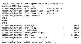

    After replacing the MCU, removing the last 'C' of the meta data and checking the results are as follows. (ROMVer: 0x2)
    Even if I change the HSM-Rt to the same in the QSPI SBL example using that MCU, it still bricks.
    Additionally, this is the UART log if I didn't change the MSRAM_HSMRT location.

  • Hi ,
    The PG Version as 3 and ROM version as 2 is the correct device variant. Also the 9ms time gives an hint that the time taken by ROM is a real time to sample/install the image.
