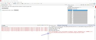

I'm using LP-AM243x, I tried switching UART mode and OSPI mode manually both are working fine.
Now I'm trying to Switch the bootmode by using *.js (change_boot_mode.js) in CCS Scripting console.
I tried writing various bootmode values in 0x78100000 location and executed the .*js.
from logs I can see that Bootmode is selected but after that I'm getting error mentioned below,
Getting log like this:
js:> loadJSFile ("C:/ti/mcu_plus_sdk_am243x_08_05_00_24/tools/ccs_load/am243x/change_boot_mode.js")
Connecting to MCU Cortex_R5_0!
Current Boot Mode is 120
Partition Unlocked..
OSPI Boot Mode Selected
Error writing memory: Errors during memory.writeData(): Address: 0x43018170 Error: 0x80000 (C:\ti\mcu_plus_sdk_am243x_08_05_00_24\tools\ccs_load\am243x\change_boot_mode.js#207)
