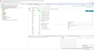

    It is probably due to incorrect MPU settings for DDR4, Please add the following in the example.syscfg for R5F1_0 --> MPU ARMv7:
    Ming

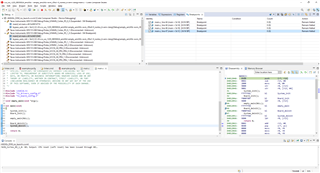

    Then, BEFORE to run, I try to add a breakpoint in the firmware of core R5FSS1-0 and I get the error message.
    As you can see from the screenshot, both cores are stopped and core R5FSS1-0 execution flow is ready to start from main (my red arrow).
    I try to add a breakpoint in the place rounded in red and I get the error message.
    (messages from the console attached after the screenshot)

    MAIN_Cortex_R5_0_0: Error: (Error -1170 @ 0x0) Unable to access the DAP. Reset the device, and retry the operation. If error persists, confirm configuration, power-cycle the board, and/or try more reliable JTAG settings (e.g. lower TCLK). (Emulation package 9.10.0.00080)
    MAIN_Cortex_R5_0_0: Unable to determine target status after 20 attempts
    MAIN_Cortex_R5_0_0: Failed to remove the debug state from the target before disconnecting. There may still be breakpoint op-codes embedded in program memory. It is recommended that you reset the emulator before you connect and reload your program before you continue debugging
    MAIN_Cortex_R5_1_0: Error: (Error -1170 @ 0x0) Unable to access the DAP. Reset the device, and retry the operation. If error persists, confirm configuration, power-cycle the board, and/or try more reliable JTAG settings (e.g. lower TCLK). (Emulation package 9.10.0.00080)
    MAIN_Cortex_R5_1_0: Unable to determine target status after 20 attempts
    MAIN_Cortex_R5_1_0: Failed to remove the debug state from the target before disconnecting. There may still be breakpoint op-codes embedded in program memory. It is recommended that you reset the emulator before you connect and reload your program before you continue debugging

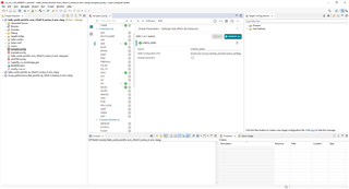

    The only difference of my ccxml file with the generic one is that mine does use gel file for any R5F cores nor the DMSC core.
    Ming

    Anyway, the main difference is that in my configuration I have only 2 cores, not 4.
    If there is a bug in CCS could be that the "second" core must be R5FSS0-1 but in AM2432 the "second" core is R5FSS1-0.
    Please try a debug configuration with AM2342_AVL. (not AM2434).
      Andrea
  • Hi Andrea,
    I tried the newly created ccxml file (without gel files) for the AM2432_ALV on AM243x EVM. I can set up the HW breakpoint for R5F_0_0 and R5F_1_0.
    Attached please find the ccxml file for AM2432_ALV.
    There is no bug in the CCS regarding to the R5F cores. There two clusters in the AM243x SoC. Each cluster has two R5F cores. When you use AM2434_ALV, then all 4 R5F cores are used R5F_0_0 and R5F_0_1 belong to the 1st cluster and the R5F_1_0 and R5F_1_1 belong to the 2nd cluster. If you are using the AM2432_ALV, then only the first R5F core of each cluster are used, i.e. only the R5F_0_0 and R5F_1_0 are used. This way, the whole 128KB TCM in the same cluster can be used by the R5F core in the cluster.
    Ming
