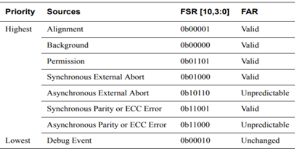

  • It should work as you say, but I get a _dabort exception. If I debug, _dabort happens when I try to access port->DSET or port->DCLR when using systemPORT.
    I thought it may be a MPU configuration, but I unchecked "Enable MPU" and "Enable MPU Background Region" and dabort still happens...
    Is there any AN where _dabort exception causes are fully explained?
  • Hi David,
    Please check the value of the Data Fault Status Register (DFSR) of the Cortex-R CPU. It is one CP15 register. CCS-->View-->Registers-->CP15-->DFSR
