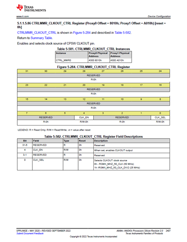

    The CLOCKOUT0 pin has a dedicated CTRLMMR_CLKOUT_CTRL register as described in the device TRM (AM243x TRM (Rev. E). Including screenshot below for reference.
    To enable 50 MHz signal, Bit0 (CLK_SEL) should be set to 0, and Bit4 (CLK_EN) should be set to 1.

    I'm questioned about AM2634, not AM2434. I could find CTRLMMR_CLKOUT_CTRL in AM2634 TRM, but could not find CTRLMMR_CLKOUT_CTRL in AM2634 register TRM.
    And also, as I understand, the default CLK_OUT is 25Mhz, How it can be set to 50Mhz?

    Apologies for the device mix-up here.
    For, AM263x the default clock source for CLKOUT0 is CORE_PLL_HSDIV0_CLKOUT1 by default (500 MHz).
    You could then configure the TOPRCM_CLKOUT0_DIV_VAL to AAAh (multi-bit decimal 10), this divider will result in 500/10 = 50 MHz signal provided to the CLKOUT0 pin.
