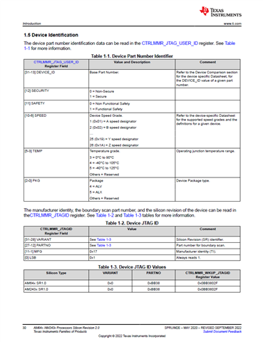

I'm looking at enabling in the field provisioning (also factory provisioning) of devices that are using the AM243x/AM64x family of Sitara products. I would like to be able to uniquely identify each module and was hoping the SoC had a register containing a unique identity (such as lot code / line build information, or potentially a unique serial number).
I would use this to be able to generate targeted firmware or provision only individual devices in the field.
Is there anything like this available in the register map that could be used and would not change, it also needs to be guaranteed unique across all units.
