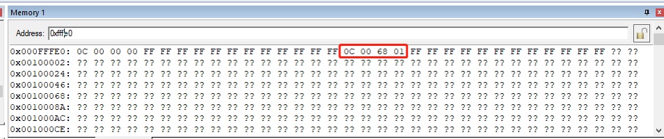

    I also have another problem. A written flash address can't be erased
    - How did you erase the part? By CCS?
    - Can you reload a simple program like the blinky or hello? After you load the program, do you still see the same issue?
    - Is this on your custom board?
    - Can you repeat the same problem on a different board?

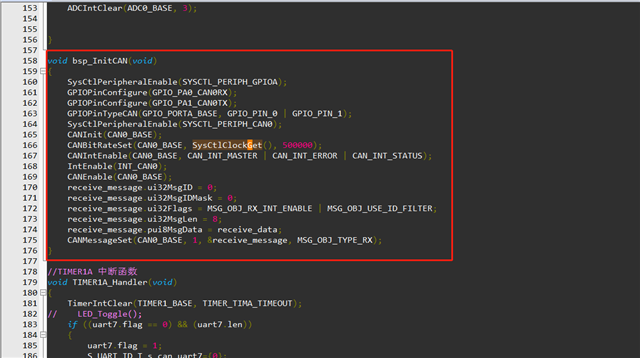

  • I encountered a problem while debugging the CAN function on my side. I used the CAN tool to send can data to the development board, but the program did not enter the can interrupt. Please help me find out where the configuration problem is?
    If you need the entire project, I can package it and send it to you
      One thing I quickly spot is that you use SysCtlClockGet(). You cannot use this API as this API is only for TM4C123 MCU. You are using TM4C129 device. You must use the return value of SysCtlClockFreqSet() as the input parameter for CANBitRateSet. Please refer to the can examples in C:\ti\TivaWare_C_Series-2.2.0.295\examples\peripherals\can\simple_tx.c.
