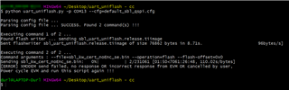

Customer converts the AM2634-CC board into an HS_SE device, it will fail when programming to the external Flash after entering the BOOT UART MODE, as shown in the figure below:
Please help check. Is there any otherprogramming method?
  • Hi ,
    This is the correct expectation because the customer needs to sign the SBL with CustMPK keys.
    Refer the following link - file:///C:/ti/tifs_am263x_08_05_00_07/docs/api_guide_am263x/html/EXAMPLES_HSM_GET_VERSION.html#autotoc_md121
    This shows how to program the SBL and Application in a HS-SE device.
