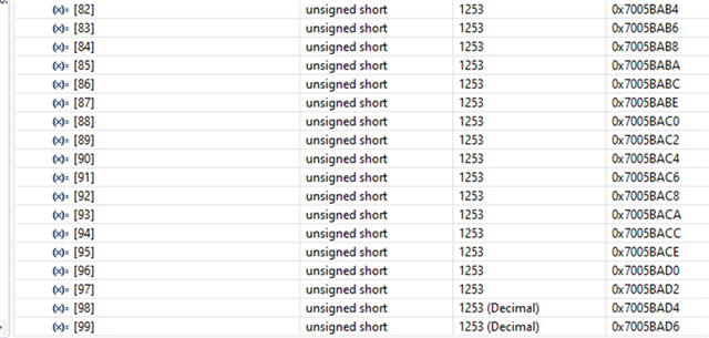

3. Test Result

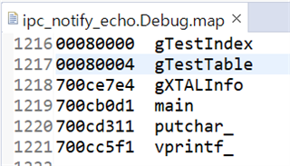

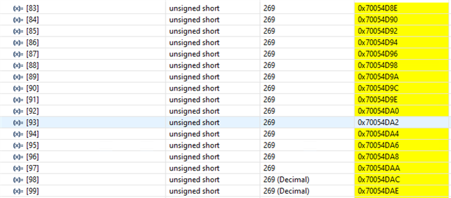

- If functions and variables are not assigned to the TCM via the "__attribute__" reserved word:
Result of both function and variable being allocated in OCRAM

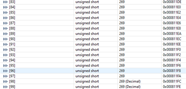

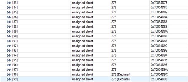

- If functions and variables are assigned to the TCM via the "__attribute__" reserved word:
Result assigned to TCMA for function and TCMB for variable
The above code was written for testing, and the code to be applied in practice is more complex.
However, the load increased when the actual code was assigned to TCM in the same way.
What are these causes?

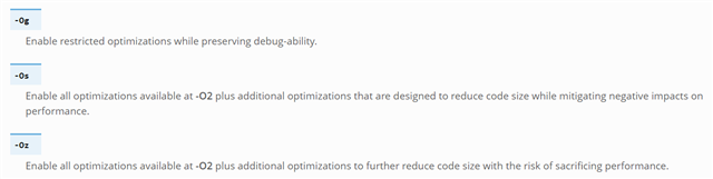

    For more information on Optimizations:
    https://www.ti.com/lit/an/sprad27a/sprad27a.pdf?ts=1678344317965&ref_url=https%253A%252F%252Fwww.ti.com%252Fproduct%252FAM2634

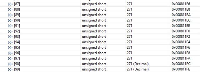

    Currently we have PWM ISR triggered when TBC is 0, and TBC is increased up to 1000.
    When TBC reaches 1000, it is automatically reset to 0.

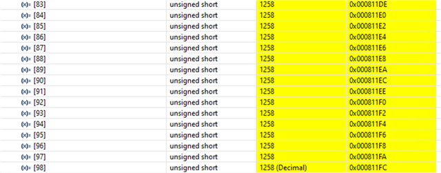

    All of the ISR routines are assigned to TCMA as shown below.
    It's better than it was before, but the load is still higher than before the allocation to TCM.

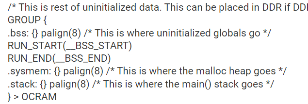

    Could you share your linker.cmd file to see where your program stack and IRQ stack are present?
    Also, are you in release mode or debug mode of build settings?
    uint16_t gCounterBufferStart[100];
    uint16_t gCounterBufferEnd[100];
    uint16_t gCounterBufferDiff[100];
    uint32_t gCounterBufferStartIndex = 0U;
    uint32_t gCounterBufferEndIndex = 0U;
    volatile bool status;
    Could you also tell me if these above variables are in TCM or OCRAM?
    Sri Vidya

    In addition, the load is the same even if the variables used for measuring the current load are assigned to TCM.
    (If you look at the address on the right of the figure below, you can see that it is assigned to TCMB.)

  • Hi Jiung Choi
    I will try to replicate your issue at my end and reply here soon. Please allow me some time. Thanks for your patience and sending this.
    We did see similar issue many times as the code is not placed entirely in TCM. And there would be jumps from TCM to OCRAM in the program which increases the execution time.
    I see that the global variables are in OCRAM:
    Could you move them to TCM?
    My recommendation would be to use the below linker.cmd file and run the application in release mode with Optimisation set to -z for better performance.
    linker.zip

    Could you try the below options which are low level compared to -Oz. Just providing this for more information.
    https://software-dl.ti.com/codegen/docs/tiarmclang/compiler_tools_user_guide/compiler_manual/using_compiler/compiler_options/optimization_options.html
    Apart from the Optimizations, I still should be able to get the TBCTR lower than OCRAM. Will update soon.

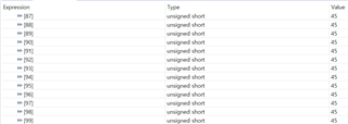

  • Hi, Sri Vidya
    First of all, the above answer did not solve the issue. (wrong click)
    Even though I moved all global variables to TCMB, the load is measured as below. (When not using TCM :41)
    Therefore, we still believe that using TCM is slower.
    Global variables assigned to TCM can be checked as follows.
    Please let me know if there are any additional things to try.
    Best Regards
    Jiung Choi
  • Hi Jiung Choi
    I performed the same experiment in Debug and Release modes.
    My TBPRD value for PWM is 10000
    TBCLK is 200MHz.
    Make Load function is as below:
    These are the results in debug mode:
    Without TCM:
    With TCM:
    In Release mode, the below are the results:
    Without TCM:
    With TCM:
    In this case, the TCM and OCRAM seems to have similar performance.
    Sri Vidya

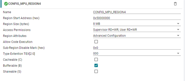

    I have also tried changing the MPU Settings of EPWM Module as shown below:
    SDK App Guide for basic info à https://software-dl.ti.com/mcu-plus-sdk/esd/AM263X/latest/exports/docs/api_guide_am263x/KERNEL_DPL_MPU_ARMV7_PAGE.html
    MPU Configuration can be done through Syscfg for a specific memory region length. The drop downs help in understanding different types of access:
    1. By default TCM memory is configured as cached.
    2. By default other memory regions are configured as strongly ordered.
    The above Attributes in the Syscfg are explained in the ARM R5 TRM in the below table:
    https://documentation-service.arm.com/static/5f042788cafe527e86f5cc83?token=
    Refer to Section à 4.3.21 c6, MPU memory region programming registers
    Below are the results obtained after the MPU region configuration:
    Without TCM:
    With TCM:
