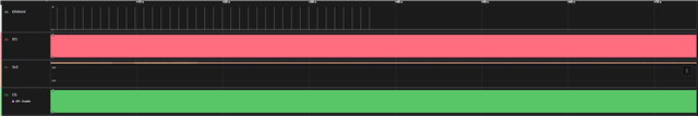

This is a logic analyzer capture of the behavior I am seeing. Relevant signals are "EthRxInt" & "3v3". "EthRxInt" refers to GPIO pins I have set within the C0_RX_PULSE interrupt upon entrance & exit. The "3v3" line is the power rail being supplied to the DP83822HFRHBR and is stable.

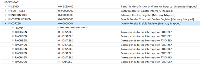

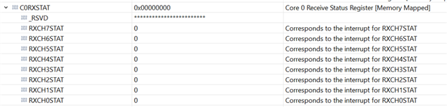

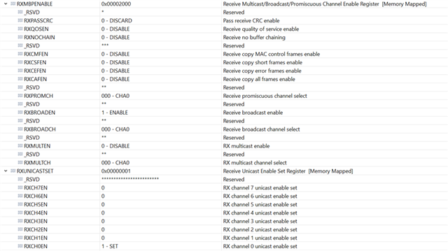

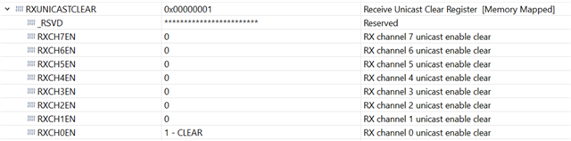

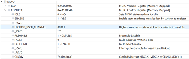

In order to test the stability of the TCP server that I am running on the TMS570 I am simply sending out pings to the device & seeing if the server responds to the ping. These pings trigger the C0_RX_PULSE interrupt & processing of the pings is carried out in the interrupt. Upon failing these are the states of relevant EMAC/MDIO registers:
RXINTMASKS:
RXUNICASTSET / RXMBPENABLE:
RXUNICASTCLEAR:
C0RXEN:
Interrupt Flag:
MDIO CLK @ 1 MHz:
