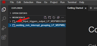

    2. You can keep main work folder where it is convenient, you can then right click on Project Explorer and choose "Add Folder to Workspace" option, then navigate to Firmware directory (same assumptions as for #1 still stand). This extra directory will be added to original folder (aka workspace).. You could actually add a second or third repo the same way.  The main requirement is project names (e.g. ATS_Booloader) still need to be unique after multiple folders are opened this way.
    E.g. using your example : let's you had a cloned repo in "AtsGitRepo" and "AtsGitRepCopy" where contents was identical, they were just located in different dirs on the filesystem. You could add both of these folders, but second folders projects would not have cube overlay which indicates that they are not buildable.

  • The main reason asking is because the sysconfig tool and compilation apparently didn’t work for them when opening a folder.
     Can you maybe explicitly show a screenshot of the cube icon overlay you are referring to?  I’m not exactly sure where they should look for this either.
    TY,
    Chris
  • Hi Chris,
    What version of CCS Theia have they installed?
    I believe the cube Icon that Martin is referring to is this one in the bottom corner of the project folder:

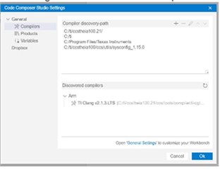

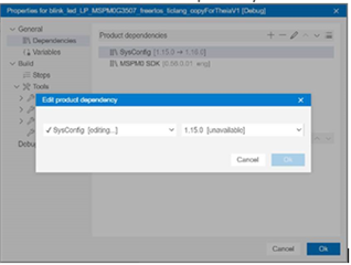

  • The lead engineer has tried this - added the path to version 1.15
    But still can’t select 1.15 as a dependency.
    What do you guys think on this?  Something trivial…?
    Chris
  • Posting this here since the last follow-up was via Email:
    Per Martin,
    First picture is showing/detecting Compilers only. Please click on Products and then add a path to SysConfig v1.15.
    Once discovery runs you should see 2 versions of SysConfig in bottom portion of the window. After that you should be able to select it in the drop down.
    Please have them give that a try and follow up if that solves their issue.
    Brandon Fisher

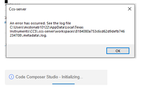

  • That worked.  They missed the step to click Products and also added the path to the wrong list.  The Sysconfig tool opens now for files sysconfig files in the workspace.
    Their end game is to load a project from outside of the workspace (or set a relative path to a project outside of the workspace).  Using Menu à Open Folder for this but it currently generates an error and appears stuck initializing.

  • Martin and Team,
    Just to clarify, the remaining pesky issue "Using Menu --> Open Folder for this but it currently generates an error and appears stuck initializing." is the last inquiry we'd like to resolve for the customer.  Thank you again in advance for your support on this.
    -Chris
  • Hi Chris,
    I am able to reproduce the issue, and I will fix this bug for the next release (v1.1.0).  In this particular scenario, the user opened a single project's root folder, and used that as the workspace - C:\Projects\TI Migration\Firmware\blink_led_LP_MSPM0G3507_freertos_ticlang.  Although this should be supported, and should not result in an error, this is not the most practical approach.
    It would be better if the user opened the parent directory as the workspace - C:\Projects\TI Migration\Firmware.  That would allow the user to work with all projects in the "Firmware" directory.  In general, the File > Open Folder... action is meant to open a directory that contains one or more projects (as its direct children).  This is referred to as a "single root workspace" - the directory "Firmware" is the single workspace root, containing one or more projects in it.
    An alternative approach is the "multi-root workspace".  In this use-case, the user can add multiple random filesystem locations to his workspace.  This can be done by right-clicking in the Project Explorer view and selecting Add Folder to Workspace... action.  Each location that user adds to his workspace is referred to as a "workspace root".  Each of these locations can either be a directory that contains one or more projects, or it can be the root of a single project.  This is the most flexible approach.  In this use-case, the user will be asked to save the workspace into a file.  This file is plain text file in JSON format, with the extension '.theia-workspace', and it will specify the paths to each workspace root.  Each workspace root can be referenced as an absolute URI, or as a relative path.  If relative paths are used, then this workspace JSON file can be source-controlled and used in a team environment.
    Let me know if this unblocks the user.  Note that the user will need to re-start CCS Theia after he opens the "Firmware" folder, to get around the stuck "Initializing" notification.
