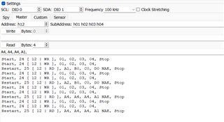

The goal of the design is to have some other host board act as an i2c/smbus master, which would trigger the slave interrupt. The master will send multi-byte write commands and single byte read commands. When prompted for a read, the slave will also need to respond with multiple bytes. Due to the multi-byte transactions, I want to leverage the i2c FIFO peripheral functionality. I have some basic functionality "working" (code posted below), but there are several quirks that I am running into, so I have several questions about the provided TivaWare API and my implementation of it.
To test my slave drivers, I am using the protocol feature on an Analog Discovery 2 (AD2) to act as an i2c master.

Read and Write Results:
The transactions are kinda working. I am using the subaddress field as a hacky way to send data when doing a read command - which the AD2 sends as a write then a read. I'd expect the output to always be A1 B2 C3 D4 after every read command. Using the debugger, I confirmed that the write messages are not getting fully parsed in, but I'd still expect to see the A B C D elements of the read since those are just hard coded constants. Furthermore, the read output changes. I think I have a fundamental misunderstanding as to how these FIFOs are supposed to be implemented. Insight is appreciated.
