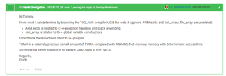

How do I begin to debug with issue:
#17003-D relocation to symbol "__TI_exidx_linkto_scn_start_1" overflowed; the 32-bit relocated address 0x8ff9dff8 is too large to encode in the 31-bit signed PC-Relative field (type = 'R_ARM_PREL31' (42), file = "<internal>", offset = 0x00000000, section = ".ARM.exidx.vectors:HwiP_armv7r_vectors_freertos_asm.o")  Project_Name C/C++ Problem
