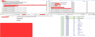

But now I can't proceed over __TI_auto_init_nobinit. It runs into an undefined-handler. I display two scenarios:
1. trampolines
So I checked the map-file again.

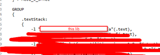

And there I found this in the FAR CALL TRAMPOLINES-section of the map-file (first value is the callee address, second trampolin address, third call-address):
the containing lib was placed explicitly in PSRAM (GPMC so the 0x5.... addresses) inside a section:
But if you look at the map-file where the SEGMENT ALLOCATION MAP is shown you see that this section explicitly is used for the lib1Code and lib2Code-run-address.
So it's not even a thing about the lib1 oder lib2 weren't loaded correctly it happens way before we come to this point, so even before we reach main().
Why is there a callee of a trampolin generated in the middle of the run-address-section? I also checked the memory view:
The register-view of CCS doesn't really help.

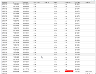

Additionally I made a core trace to catch this better:
columns are RowNo, PC, OpCode, Function, Line No, File, Directory, Cycles, Status ("undefined instruction" is the last status). Interestingle the calls before this call don't make any sense because somehow some functions are already called that should be called later on but not before main.
How can I prevent the Linker from doing such things? Or am I the one doing a mistake here?

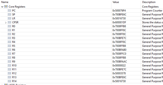

The core-trace is now really weird:

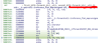

Could it be that at some earlier point the software starts to take the wrong way somehow? But the question would be: why?
I wanted to disassembly-debug the whole process but as soon as I get into the first branches inside __TI_auto_init_nobinit and in the __cxx_global_var_init which are opening the corresponding files in the view, CCS constantly crashes all the time. So it's impossible to debug this problem.

    The pop-call here:
    runs into:
    I made a screen of the registers when reaching the pop:

    So I dissassembly-stepped the procedure. The activated C++-Object has some const-init at the beginning which uses also some etl-functionality and this seems to issue the problem. Sadly I cannot completely debug, since CCS now crashes even with the workaround. But it does somewhere inside the "lower_bounds"-function somewhere in etl::flat_map. But nevertheless I think the problem is not directly located there because it works in different conditions.

  • Here is one change I am confident will help.  When partial linking, add the option -nostdlib.  By default, the compiler RTS libraries are part of a link.  This option disables that behavior.  It is documented here.  The final link needs no changes.  That is when the compiler RTS libraries are linked in.

    the final-link-map-file shows this here:
    here the both red-masked outs are the separate output-modules. This is a separate section of the relocatable output-modules which contains the text-sections of a linked-in-library in their run-address (textFastLibs of the first post in this thread). The sys_mem just got automatically put behind them.
