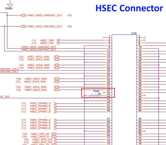

Looking at the PROC110E2 schematic I have a few questions:
1) Pin 43 is listed as NC in the Hardware User's Guide (page 49: https://www.ti.com/lit/ug/spruj09c/spruj09c.pdf?ts=1676648505407) but in the PROC110E2 schematic I see a resistor connecting this pin to GND.
is this resistor R343 normally a do-not-install? I don't see an alternate function for this pin so am curious why R343 was included at all.

    1) HSEC Pin 43 is connected to ADC_VREFLO directly in the E1 design of the Control Card. For the E2 design, this was determined to be redundant as ADC_VREFLO is connected directly to GND via a OΩ resistor. Pin 43 can either be NC by removing R343 or GND by keeping it installed.
