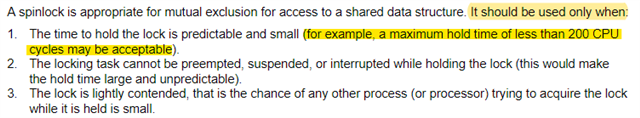

    Customer has some questions regarding to spinlock HW.  In the TRM, we suggest when use the spinlock, the maximum hold time should be less than 200 CPU cycles. So we suggest using for share memory access protect only.
What happens if this time is larger than 200cycles? Will spinlock be unlocked?

  • G Kowshik,
        According to test,  HW spinlock will not automatically unlock after 200cycles. If you review TRM descriptions across all AM24,AM26,AM27,  they all emphasizes 200cycles limitation. it's really weird. Can you please check why TRM emphasizes this limitation so much. Thanks.

  • Hi Andre,
    I have received some reply on this case. It’s a guiding principle in software design to keep critical section small ( it’s even more important if you are implementing critical section by disabling interrupts globally - current SDK way). Advantage with spinlock is that it is not disabling interrupts, hw spinlock is the only way to implement multi core critical section and you can always yield a lower priority task if critical section is already taken by other core.
    So, it is not exactly a requirement to use splin lock, however if user wishes to use these then it's a recommendation to keep the critical section access locked by the spinlock for smaller times.

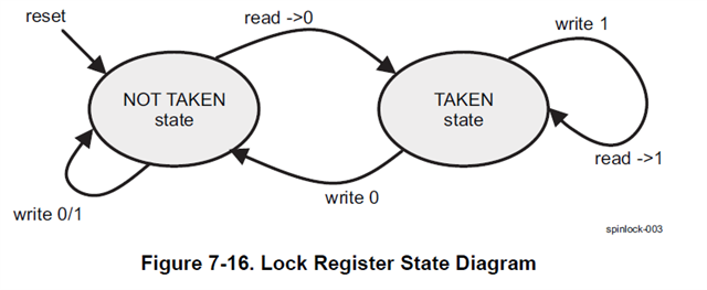

  • G Kowshik,
        May I get your confirmation regarding HW behavior?
    Once one core get and put this spinlock into taken state, what will happen after 200 cycles? Will this spinlock keep in taken state until some one unlock it?
    Andre
  • Hi Andre,
    I have checked the experts more deep here. They are saying no such restriction on timing is required because no such use-case has been validated til now or come across. I am checking with HW apps team to handle the behaviour of hardware. I will update you once I hear back.
